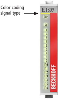

Color coding
Color coding 1:Fig.17: EJ modules color code; sample: EJ1809
The EJ modules are color‑coded for a better overview in the control cabinet (see diagram above). The color code indicates the signal type. The following table provides an overview of the signal types with corresponding color coding.
