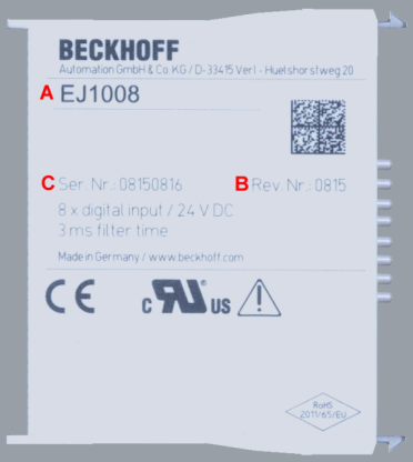

The Order identifier and the revision number are printed on the side of EtherCAT plug-in modules (s. following illustration (A and B).
Fig.1: Order identifier (A), Revision number (B) and serial number (C) using the example of EJ1008Product group | Example | ||

The serial number for EtherCAT plug-in modules is usually the 8-digit number printed on the side of the module (see following illustration C). The serial number indicates the configuration in delivery state and therefore refers to a whole production batch, without distinguishing the individual modules of a batch.
Fig.1: Order identifier (A), revision number (B) and serial number (C) using the example of EJ1008Serial number | Example serial number: 08 15 08 16 |
