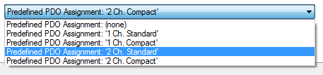

Predefined PDO Assignment
The "Predefined PDO Assignment" enables a simplified selection of the process data. The desired function is selected on the lower part of the "Process Data" tab. As a result, all necessary PDOs are automatically activated and the unnecessary PDOs are deactivated.
Four PDO assignments are available:
SM3, PDO assignment
1 Ch. Standard
0x1A00 (FB Inputs Channel 1)
1 Ch. Compact
0x1A02 (FB Inputs Channel 1 compact)
2 Ch. Standard
0x1A01 (FB Inputs Channel 2)
2 Ch. Compact
0x1A03 (FB Inputs Channel 2 compact)
Predefined PDO Assignment 1:Fig.26: Process data tab Predefined PDO Assignment, EJ5042-0010
