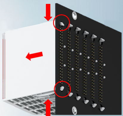

To disassemble the module from the signal distribution board proceed as follows:
  1. Before disassembly, ensure that the signal distribution board is securely connected to the mounting surface. Disassembly of an unsecured signal distribution board may result in damage to the board.
  2. Press the upper and lower mounting tabs simultaneously and pull the module from board while gently moving it up and down.
