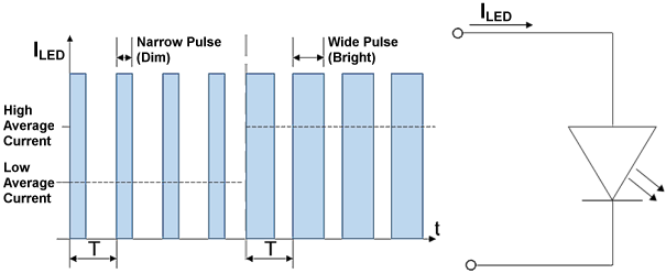

b. Pulse width modulation (PWM)
If the constant current or constant voltage with series resistor is clocked quickly in the kHz range, this is referred to as a PWM mode. The true-color brightness can then be adjusted by adapting the duty factor of the pulse width modulation (PWM). By switching the power supply on and off with a sufficiently high frequency and a preset duty cycle (0...100 %), the flashing appears to the human eye like a continuous light. By changing the duty cycle, the current averaged over time is reduced or increased by the LED, thus adjusting the brightness.
- Advantages: true-color brightness adjustment
- Disadvantages: supply must be able to provide rapidly increasing currents, complex supply source may be required

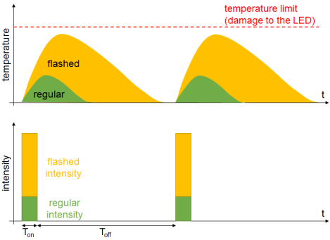

2. Pulse operation
In some applications an “overdrive” may be desired, as the light power in continuous operation with the nominal current is insufficient. The LED is operated briefly for a few µs to ms with a considerably higher power than in nominal operation by means of a brief and pulsating increase in the current above the nominal current. This results in briefly higher luminous fluxes. The LED can cool down again in the subsequent pause.
Overdriving leads to increased development of heat in the LEDs. The temperature of the LED chip must not increase beyond the temperature limit value during the pulse. The LED will otherwise be damaged. Following a pulse, there must be a sufficiently long pause (switch-off time) before the next pulse so that the LED can cool down. The ratio of switch-on to switch-off time is set by the duty cycle. A maximum duty cycle of 10% is often set for pulse operation. Hence, the pulse duration may not exceed 10% of the entire period. The precise values are to be taken from the manufacturer's data sheets.
- Advantages: The maximum luminous flux of the LED can be utilized. If the duty cycle is adhered to or undershot, the waste heat created is at the most as much as in continuous operation. If the maximum duty cycle is undershot so that the average power is less than in continuous operation, this can lead to less aging and thus to a longer service life.
- Disadvantages: Requires a more elaborate circuit and control solution, for example in the form of a flash controller
