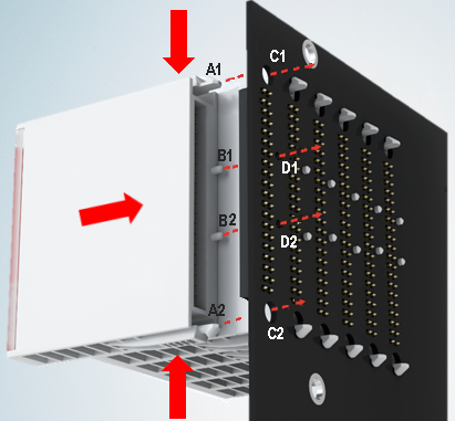

A1 / A2 | Latching lugs top / bottom | C1 / C2 | Mounting holes |
B1 / B2 | Coding pins | D1 / D2 | Coding holes |
To install the modules on the signal distribution board proceed as follows:
- Before the installation, ensure that the signal distribution board is securely connected to the mounting surface. Installation on an unsecured signal distribution board may result in damage to the board.
- If necessary, check whether the positions of the coding pins (B) match the corresponding holes in the signal distribution board (D).
- Compare the device name on the module with the information in the installation drawing.
- Press the upper and the lower mounting tabs simultaneously and push the module onto the board while gently moving it up and down, until the module is latched securely.
The required contact pressure can only be established and the maximum current carrying capacity ensured if the module is latched securely. - Use placeholder modules (EJ9001) to fill gaps in the module strand.
