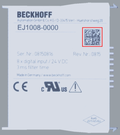

Depending on the product, it can be found in the following places:
- on the packaging unit
- directly on the product (if space suffices)
- on the packaging unit and the product
The BIC is machine-readable and contains information that can also be used by the customer for handling and product management.
