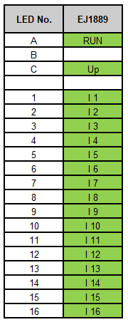

LEDs
Fig.15: EJ1889 - LEDsLED | Color | Display | State | Description |
RUN | green | off | Init | State of the EtherCAT State Machine: INIT = initialization of the plug-in module |
flashing | Pre-Operational | State of the EtherCAT State Machine: PREOP = function for mailbox communication and different standard-settings set | ||
Single flash | Safe-Operational | State of the EtherCAT State Machine: SAFEOP = verification of the Sync-Manager channels and the distributed clocks. | ||
on | Operational | State of the EtherCAT State Machine: OP = normal operating state; mailbox and process data communication are possible | ||
flickering | Bootstrap | State of the EtherCAT State Machine: BOOTSTRAP = function for firmware updates of the plug-in module | ||
Up | green | off | - | No 24 VDC power supply connected |
on | - | 24 VDC power supply connected | ||
I1 ... I16 | green | off | - | Signal voltage "0" (18 V ... 30 V) |
on | - | Signal voltage "1" (0 V ... 7 V) |
