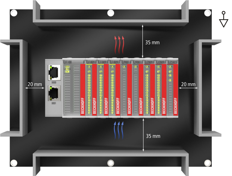

Optimum installation position (standard)
For the optimum installation position the signal distribution board is installed horizontally, and the fronts of the EJ modules face forward (see Fig. Recommended distances for standard installation position). The modules are ventilated from below, which enables optimum cooling of the electronics through convection. “From below” is relative to the acceleration of gravity.
Installation positions 1:Fig.15: Recommended distances for standard installation position
Compliance with the distances shown in Fig. Recommended distances for standard installation position is recommend. The recommended minimum distances should not be regarded as restricted areas for other components. The customer is responsible for verifying compliance with the environmental conditions described in the technical data. Additional cooling measures must be provided, if required.

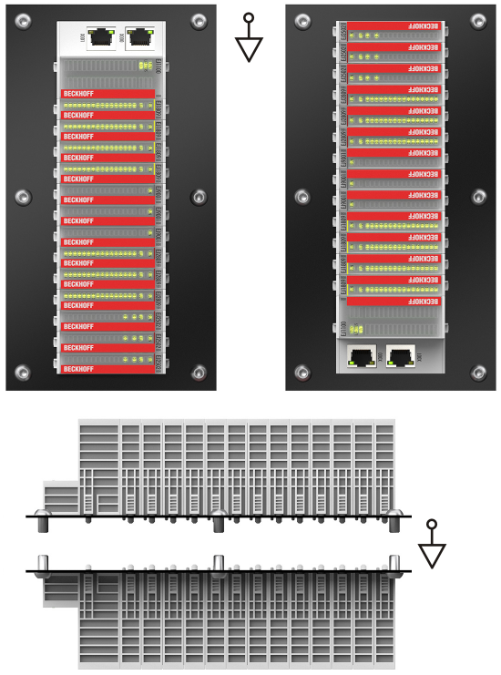

Other installation positions
All other installation positions are characterized by a different spatial position of the signal distribution board, see Figure Other installation positions.
The minimum distances to ambient specified above also apply to these installation positions.
Installation positions 2:Fig.16: Other installation positions
