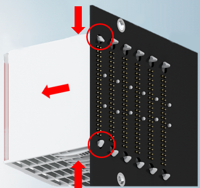

Each module is secured through latching on the distribution board, which has to be released for disassembly.
To disassemble the module from the signal distribution board proceed as follows:
- Before disassembly, ensure that the signal distribution board is securely connected to the mounting surface. Disassembly of an unsecured signal distribution board may result in damage to the board.
- Press the upper and lower mounting tabs simultaneously and pull the module from board while gently moving it up and down.
