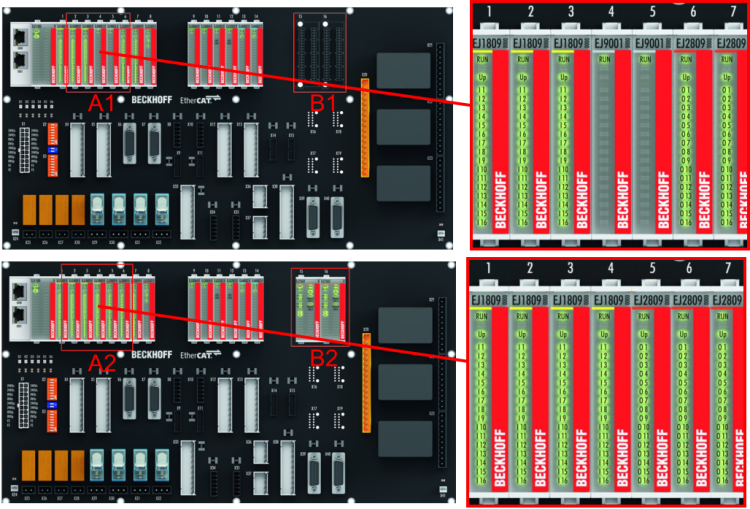

The EJ9001 placeholder modules are used to close temporary gaps in the module strands (see Figure below A1). Gaps in the module strand cause interruption in EtherCAT communication and must be equipped with placeholder modules.
In contrast to the passive terminals of the EL series, the placeholder modules actively participate in the data exchange. Several placeholder modules can therefore be connected in series, without impairing the data exchange.
Unused slots at the end of the module strand can be left as reserve slots (see Figure below B1).
The machine complexity is extended (extended version) by allocating unused slots (see Figure below A2 ‑ Exchanging placeholder modules and B2 ‑ Assigning reserve slots) according to the specifications for the signal distribution board.
Using placeholder modules for unused slots 1:Fig.20: Sample: Exchanging placeholder modules and assigning reserve slots
Using placeholder modules for unused slots 2:
