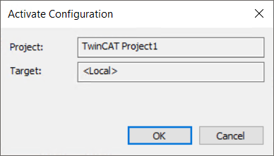

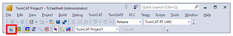

- 1. Activate the TwinCAT configuration
- A dialog box appears.
- 2. Confirm with OK
- 3. Confirm with OK
