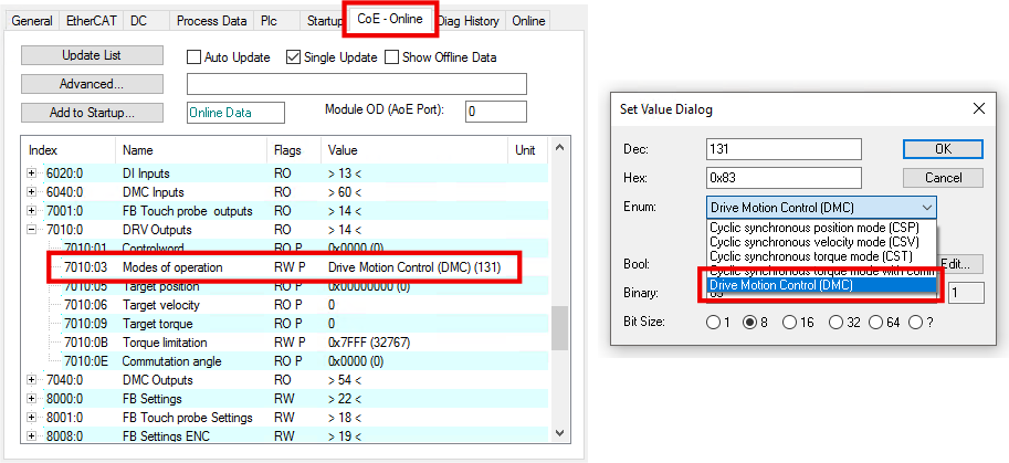

- 1. Set the operation mode “Drive Motion Control (DMC)” in CoE parameter 0x7010:03 “Modes of operation”.

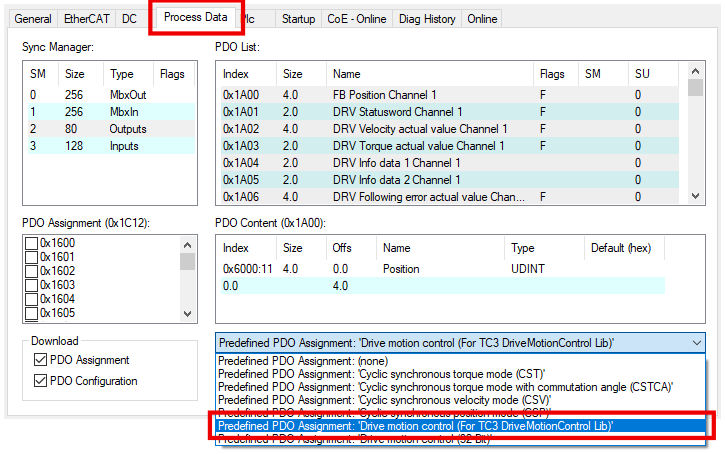

- 2. Activate the Predefined PDO Assignment “Drive motion control (For TC3 DriveMotionControl Lib)”.
- The process data for using Drive Motion Control is activated.

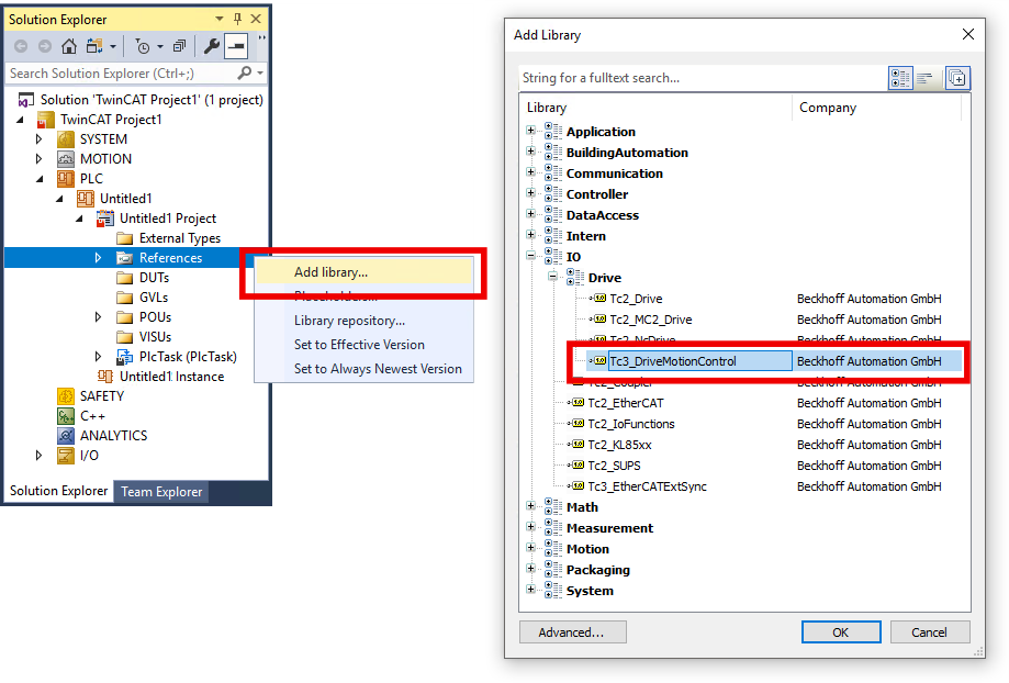

- 4. Add the “Tc3_DriveMotionControl” library to the PLC project.
(If you want to use Drive Motion Control without the “Tc3_DriveMotionControl” library, see the chapter at State machine.)

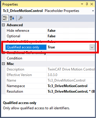

- 5. If the “Tc3_DriveMotionControl” and “Tc2_Mc2” libraries are used simultaneously in the current project:
In the “Properties” window, set the “Qualified access only” property for one of the two libraries to “True”.
- The library “Qualified access only” can now only be accessed in the PLC code via the corresponding namespace, e.g.:
Tc3_DriveMotionControl.MC_Stop()
This prevents naming conflicts, such as when calling the function blockMC_Stop, which has the same name in both libraries. - 6. Declare a variable of type “AXIS_REF” in the PLC. Example:

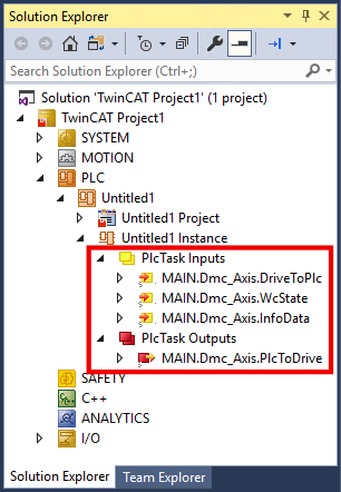

- 8. In the Solution Explorer link the PLC variables with the process data of ED7062.
