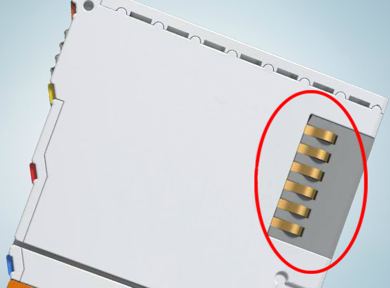

  • When handling the components, take care to avoid electrostatic discharge; also, prevent direct contact with the spring-loaded contacts (see illustration).

Fig.19: Spring contacts of Beckhoff I/O components
