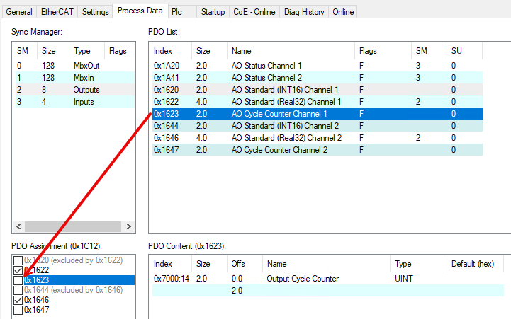

During the commissioning phase and potentially also during ongoing operation, it may be useful to monitor the regular and timely arrival of the setpoint at the device. For this purpose, the 16-bit counter Output Cycle Counter can be enabled channel by channel in the PDO assignment:
AO Continuity counter 1:
Fig.44: Enabling the 16-bit counter via PDO assignment 0x1623
