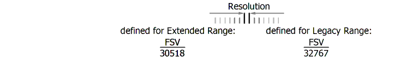

Fig.45: Defined resolution, 16-bitSetting:

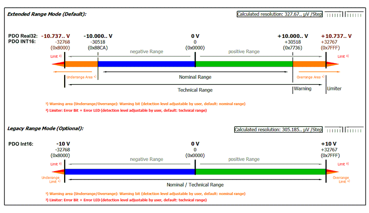

Output range ±10 V (bipolar)

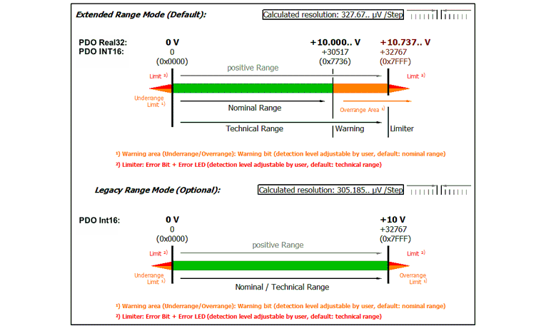

Fig.47: Output range ±10 V (bipolar)Output range 0...10 V (unipolar)

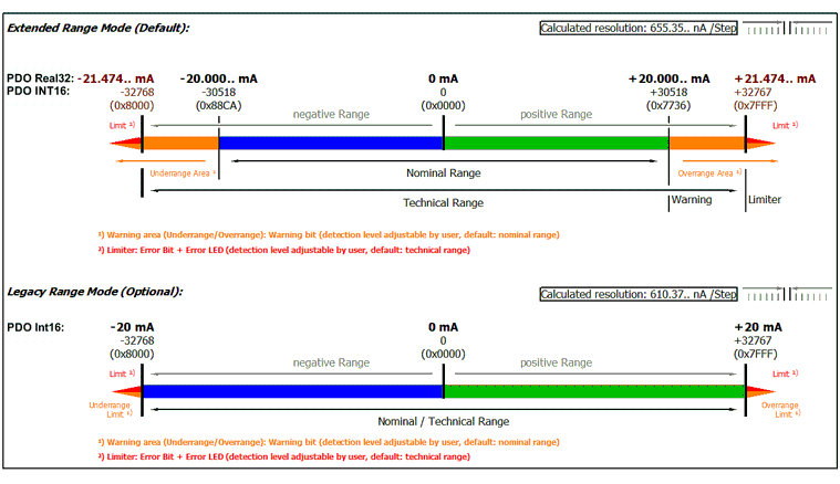

Fig.48: Output range 0 - 10 V (unipolar)Output range ±20 mA (bipolar)

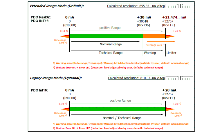

Fig.49: Output range ±20 mA (bipolar)Output range 0...20 mA (current loop)

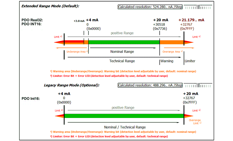

Fig.50: Output range 0...20 mA (current loop)Output range 4...20 mA (current loop)
Fig.51: Output range 4...20 mA (current loop)
