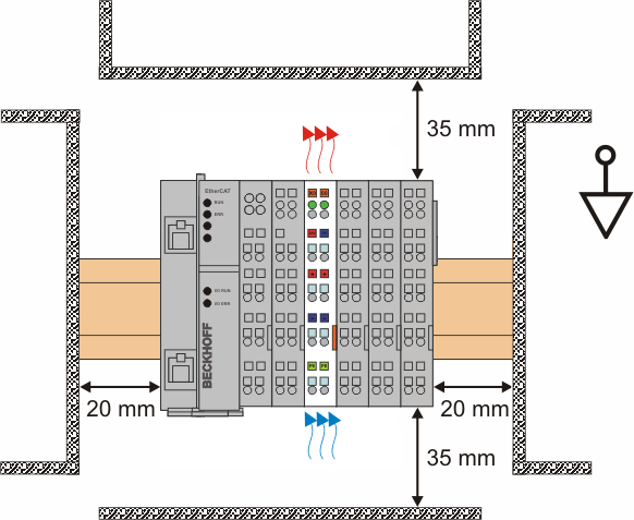

Horizontal installation (standard installation)
The mounting rail is mounted horizontally on a vertical mounting plate.
The connection level of the devices points to the front.
The devices are ventilated from below, which enables optimum cooling of the electronics through convection. This is therefore also the recommended installation position.
Installation positions 1:Fig.20: Recommended minimum distances for standard installation position
Notice
Compliance with the minimum distances
Compliance with the minimum distances shown in the figure "Recommended minimum distances for standard installation position" is strongly recommended in all installation positions.
