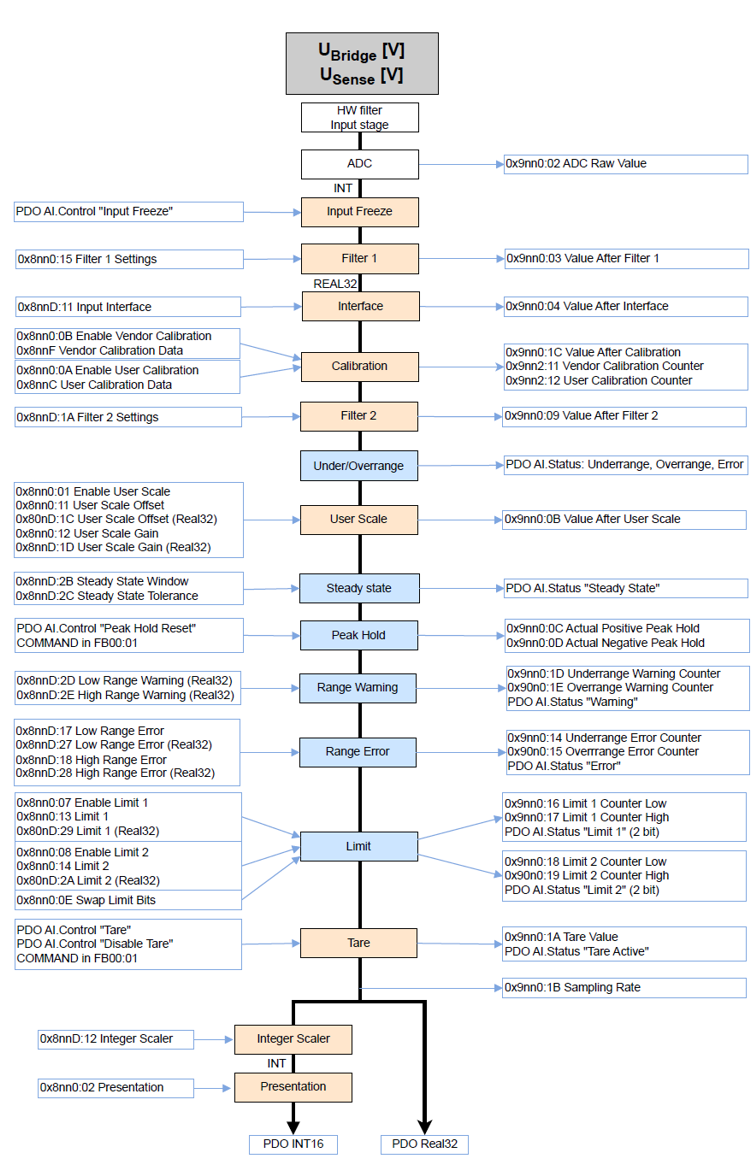

Data flow analog input voltage measurement
Data flow analog input voltage measurement 1:
Fig.20: Data flow analog input
Data flow diagram legend

This terminal only uses floating point calculations internally, as shown in the data flow. This considerably simplifies and shortens the commissioning of the analog channel, which minimizes errors in understanding. In addition, intermediate values throughout the data calculation can easily be displayed in the CoE.
The Real32 and INT16 values are defined in the CoE without units. However, the unit is determined by the context and should, wherever possible, be regarded as an SI unit. For example, the voltage is measured in V, the current in A (even at 20 mA input!), the resistance in ohms and the ratio in V/V and so on.
