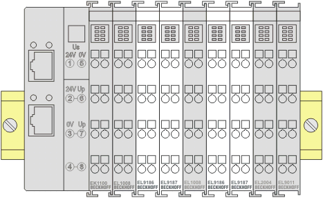

Examples for positioning of passive terminals (highlighted)
Positioning of passive Terminals 2:Fig.11: Correct positioning

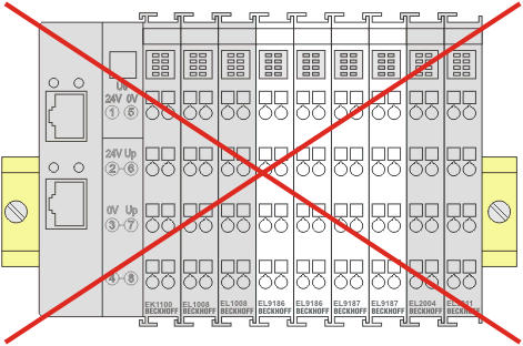

Positioning of passive Terminals 3:Fig.12: Incorrect positioning
