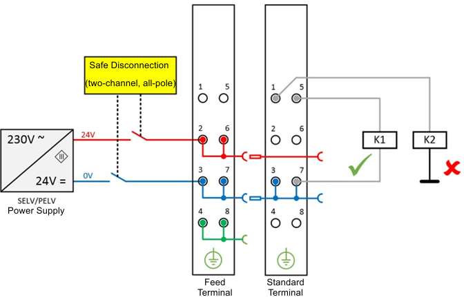

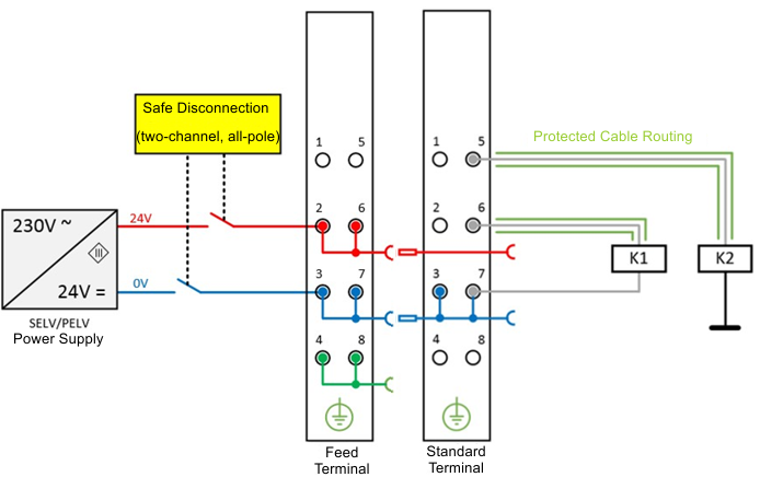

External wiring
The following requirements are to be ensured by the system manufacturer and must be incorporated into the user documentation.
Summary of safety levels
Feedback prevention measures
DIN EN ISO 13849-1
IEC 61508
EN 62061
Cable short-circuit fault exclusion
max.
Cat. 4
PL e
max. SIL3
max. SIL2*
Ground return and all-pole disconnection
max. SIL3
WARNING
Please follow the instructions for operating interference-free terminals!

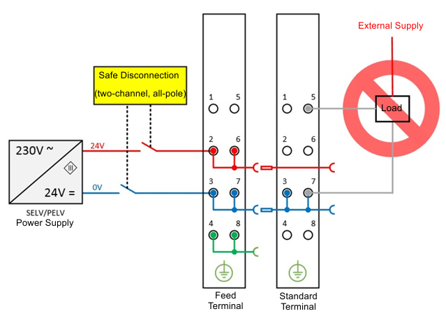

  • All terminals in a potential group must be interference-free!
  • Make sure that, even in the event of a fault, no power can be fed back through external wiring!
