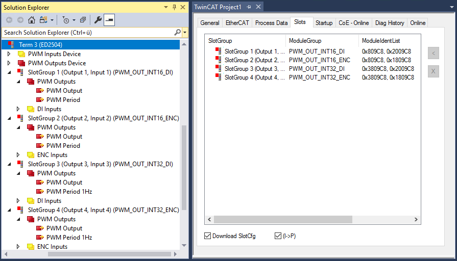

Prerequisite: A SlotGroup must be assigned a ModuleGroup that contains the ModuleIdent 0x809C8/0x3809C8 “PWM Output Pulse Width, Period (INT16/32 Legacy)”.
1. In “PWM (Integer)” operation mode, the process data are specified as integer variables, INT16 or INT32-PDO
The pulse width or duty cycle via “PWM Output” and
The period (equal to 1/frequency) via “PWM Period” (INT16) or “PWM Period 1Hz” (INT32)
PWM (Integer) - ModuleIdent 0x809C8, 0x3809C8 1:Fig.25: Module/slot assignment with process data in “PWM (Integer)” operation mode
