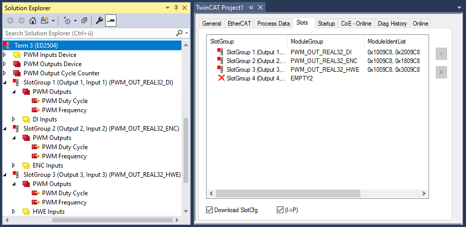

Prerequisite: A SlotGroup must be assigned a ModuleGroup that contains the ModuleIdent 0x1009C8 “PWM Output Duty Cycle, Frequency”.
1. In “PWM (Real)“” operation mode, the process data are specified as floating-point variables, REAL32 PDO:

PWM (Real) – ModuleIdent 0x1009C8 1:Fig.19: Module/slot assignment with process data in “PWM (Real)” operation mode
