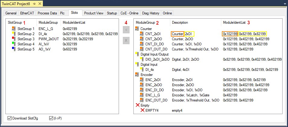

Basics of the "Modules/Slots" procedure 1:
Fig.18: Configuration in the "Slots" tab using an EL8601-8411 as example
1. The operating mode is defined for each "SlotGroup" by assigning a maximum of one "ModuleGroup". When the "SlotGroup" is selected in the left-hand field, the "ModuleGroups" available for this "SlotGroup" with the associated "Modules" are displayed in the right-hand field.
2. "ModuleGroups" describe the possible combinations of the individual "Modules". In this way, the configuration of invalid combinations can be excluded. The operation mode of the group is explained in short form in the "Description" section.
3. Each "Module" has a defined "ModuleIdent" number that is fixed to an operation mode and the corresponding process data and CoE objects.
In the "ModuleIdentList", all "ModuleIdents" of a "ModuleGroup" are displayed according to the frequency of their use (see Fig. above CNT_2xDI).
4. Each SlotGroup must be assigned exactly one "ModuleGroup" using the "<" (assign) and "X" (remove) buttons.
The process data and the CoE objects are automatically adjusted according to the selected "ModuleGroup", in the respective SlotGroup.
