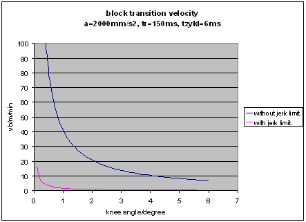

The influence of jerk limitation to block transition velocity between two non-tangential movement blocks with different knee angles is shown below.
Contour with non tangential block transitions 5:
