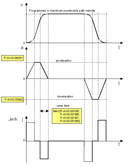

This profile can be activated for path movement and offers advantages when NC program has short blocks. In this case the acceleration must be increased and decreased over a series of short blocks.
The Parameterization of the acceleration with feed blocks is identical with the standard jerk limited profile setting, but it wouldn´t be a very good idea to use different acceleration and deceleration values with HSC processing.
The setting of profile parameters for rapid movement and feedhold corresponds to parameter setting of standard jerk limited profile.
There are differences in effectiveness of ramp time parameters for feed movement.
The ramp time in this case is the maximum of the parameters P-AXIS-00195, P-AXIS-00196, P-AXIS-00197and P-AXIS-00198. So increasing and decreasing time of acceleration and deceleration are identical.
Jerk limited HSC - acceleration profile 1:
Figure1-5: Parameters with HSC jerk limitation and feed block
