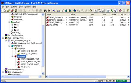

PLC test environment

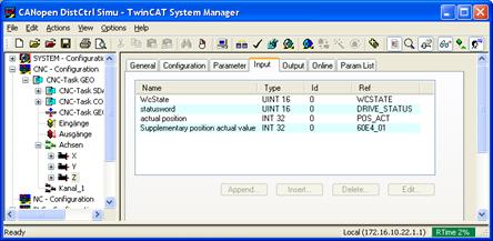

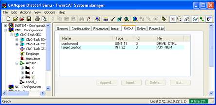

Distance control from TwinCAT-CNC Build V2.10.1505.22
Configuration of a Z axis according to CANopen DS402 drive with additional distance sensor (0x60E4_01).
Configuration of CAN drive

Simulation in PLC
Simulation of CAN-PDO via PLC inputs/outputs

In PLC the drive encoder and the distance sensor additionally are charged with a small random noise.

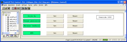

Turning on the drives
After setting of drive permission (drive on, torque, feedhold off) drive can be moved.

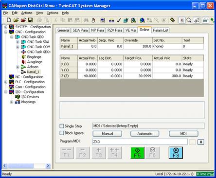

Test example with drive simulation 4:

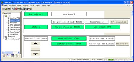

Moving on a set position

Referencing of sensor, "sensor zero"
Test example with drive simulation 6:
For the transmitted set position (SET_POS) the distance sensor delivers value = 0.
Changing the surface position "Surface offset"
The changed surface position results in a changing of the measured distance sensor.
Test example with drive simulation 7:
This causes a re-adjusting of the real axis position until the distance sensor delivers the value = 0 again. In this case the desired distance to surface is reached.
Test example with drive simulation 8:
"Freezing" of the current height
If distance control is interrupted (Transition = FREEZE = 2), in this time a changed sensor value (-20000) has no influence on the axis correction.
Test example with drive simulation 9:
After re-activation of distance control, the current sensor value is considered again.
Deselection
After deselection of distance control (Transition = OFF = 0) the position offset caused by the distance sensor is cancelled.
