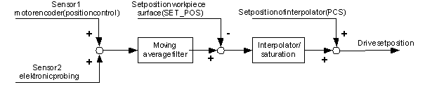

To compensate for the workpiece surface deviation, the drive position is additionally moved by the calculated offset of the distance control:
Drive setpoint = programmed setpoint (PCS) + distance control offset
Fig.5: Block diagram of distance controlSelecting and cancelling via the NC program

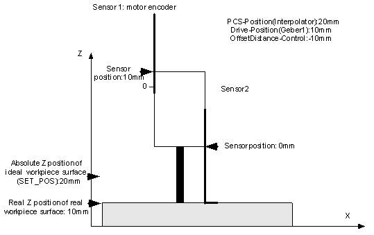

Fig.6: Ideal workpieceDeviation
A deviation from the ideal workpiece surface (e.g. in the case of a thinner workpiece) is detected by the sensor (sensor 2):

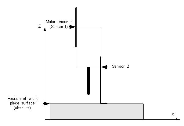

Fig.7: Real workpiece without distance controlOffset compensation
After activation of distance control with SET_POS=20 mm (expected workpiece height), the offset is compensated by the distance control. As a result, there is no need to adapt the NC program (PCS position):
