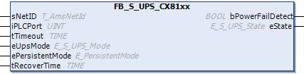

In the case of the CX81xx the function block FB_S_UPS_CX81xx k is used to control the 1-second UPS from the PLC. If possible, use the default values of the FB_S_UPS_CX81xx and call the function block cyclically in the PLC.

Inputs
sNetID : T_AmsNetId:= ''; (* '' = local netid *)
iPLCPort : UINT; (* PLC Runtime System for writing persistent data *)
tTimeout : TIME := DEFAULT_ADS_TIMEOUT; (* ADS Timeout *)
eUpsMode : E_S_UPS_Mode := eSUPS_WrPersistData_Shutdown; (* UPS mode (w/wo writing persistent data, w/wo shutdown) *)
ePersistentMode : E_PersistentMode := SPDM_2PASS; (* mode for writing persistent data *)
tRecoverTime : TIME := T#10s; (* ON time to recover from short power failure in mode eSUPS_WrPersistData_NoShutdown/eSUPS_CheckPowerStatus *)
sNetID | T_AmsNetId | AmsNetID of the controller |
iPLCPort | UINT | Port number of the PLC runtime system (851 for the first PLC runtime system, 852 for the second PLC runtime system, etc.). If you do not specify a port number, the function block then automatically determines the port of the PLC runtime system. |
tTimeout | TIME | Timeout for writing the persistent data or the quick shutdown |
eUpsMode | E_S_UPS_Mode | Defines whether persistent data are to be written and whether a quick shutdown is to be executed. The default value is eSUPS_WrPersistData_Shutdown, i.e. a quick shutdown is executed automatically once the persistent data have been saved. |
ePersistentMode | E_PersistentMode | Mode for writing the persistent data. Default value is SPDM_2PASS. |
tRecoverTime | TIME | Time after which the UPS reverts to the PowerOK status in the event of UPS modes without shutdown. tRecoverTime must be somewhat longer than the maximum holding time of the UPS in order to ensure that the capacitors are fully charged. |
Outputs
bPowerFailDetect : BOOL; (* TRUE while powerfailure is detected *)
eState : E_S_UPS_State := eSUPS_PowerOK; (* current ups state *)
bPowerFailDetect | BOOL | TRUE during power failure. FALSE if the supply voltage is present. |
eState | E_S_UPS_State | Internal state of the function block |
