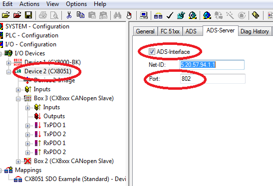

SDO data that are unknown to the CANopen part of the software and cannot be processed automatically are transferred to the PLC, where they are evaluated and answered via ADS notification.
To this end the ADS port must be enabled in the System Manager under CAN device (CX8051).
