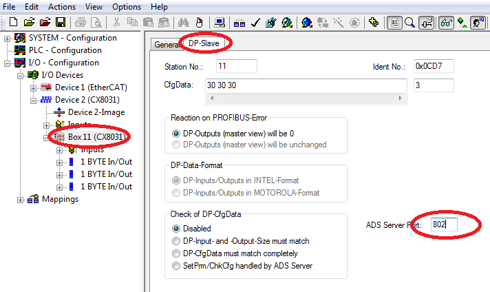

Settings in the System Manager
In order to transport the DP-V1 services into the PLC this function must be activated by specifying the port.
Port 0 deactivated, 802 PLC runtime system 1, task 1
