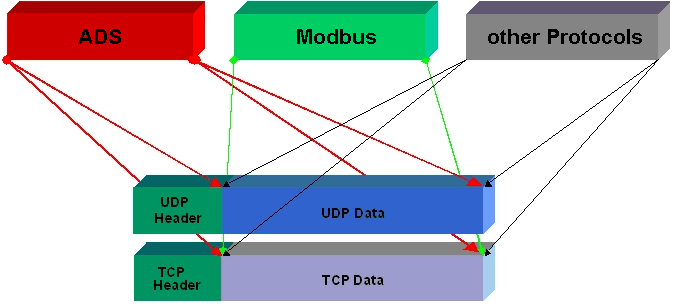

Protocols running on top of TCP/IP and UDP/IP
The following protocols can run on top of TCP/IP or UDP:
Both of these protocols are implemented in parallel on the Bus Coupler, so that no configuration is needed to activate the protocols.
Ethernet 2:
ADS can be used on top of either TCP or UDP, but ModbusTCP is always based on TCP/IP.
