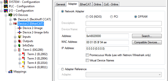

E-bus interface
The operation of E-bus terminals and EtherCAT devices is possible on the CX80xx.
The CX80xx recognizes these terminals automatically on scanning, reads out the terminal types and automatically places them in the System Manager.
Power supply terminal 2:
Power supply terminal 3:
DC Distributed Clocks
The CX80xx series is not suitable for the use of EtherCAT slaves that use or need distributed clocks functionality.
