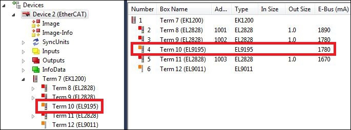

Passive EtherCAT Terminals (e.g. EL9195) can be detected in TwinCAT. The EtherCAT Terminal is displayed without process image in the structure tree, and the value in column "E-bus (mA)" does not change, compared to the preceding EtherCAT Terminal.
Installing passive EtherCAT Terminals 2:Fig.7: Identifying a passive EtherCAT Terminal in TwinCAT.
