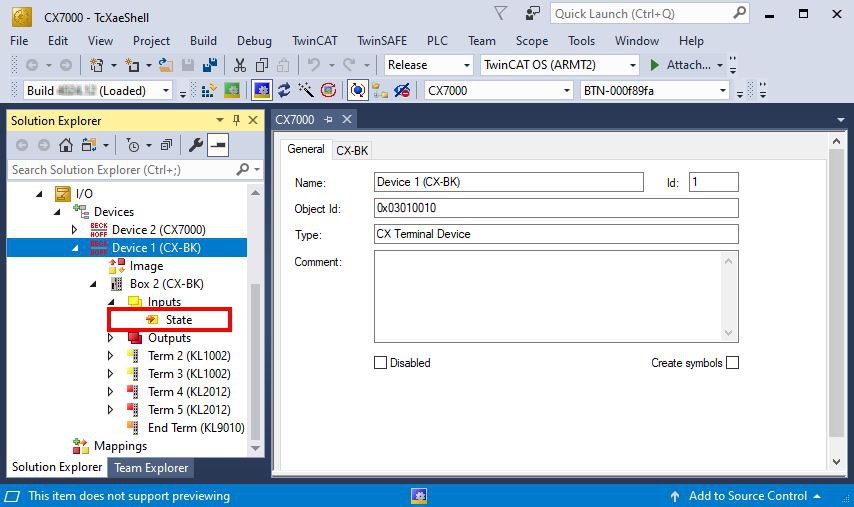

EtherCAT Terminals (E-bus) or bus terminals (K-bus) can optionally be connected directly on the right-hand side; the CX7293 automatically recognizes which system is connected during the start-up phase.
K-bus interface
The CX7293 reads out the terminal types during scanning and creates them in the System Manager under a bus coupler.
K-bus and E-bus interface 1:Fig.40: K-bus interface of a CX7293 in the TwinCAT System Manager.
For K-bus diagnostics there is a status variable in TwinCAT under the bus coupler, which can be used for diagnostic purposes and indicates the status of the K-bus communication. For more information, refer to the chapter "Error handling and diagnostics" at K-bus.

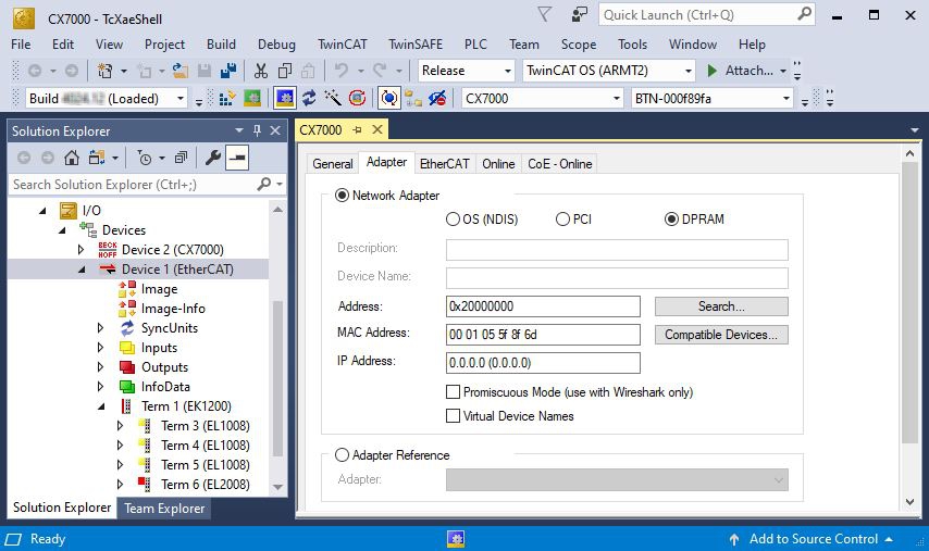

E-bus interface (EtherCAT)
K-bus and E-bus interface 2:
EoE (Ethernet over EtherCAT)
EtherCAT slaves that use EoE for communication or configuration are currently not supported on the CX7xxx.
K-bus and E-bus interface 3:
Restrictions for EtherCAT drives with distributed clocks
The Embedded PCs of the CX72xx series are suitable for the use of EtherCAT slaves that use distributed clocks or require them. However, the use of EtherCAT drives is only possible to a limited extent, as there is no motion package (TF5xxx) available for the CX72xx. For applications with EtherCAT drives, please use the CX82xx series or higher.
The operation of EtherCAT Terminals and EtherCAT devices is also possible on the CX7293. The CX7293 also recognizes these terminals automatically during scanning, reads out the terminal types and creates them in the System Manager under an EtherCAT Coupler.
K-bus and E-bus interface 4:Fig.41: E-bus interface of a CX7293 in the TwinCAT System Manager.
For more information on diagnostics, refer to the chapter "Error handling and diagnostics" at E-bus.
