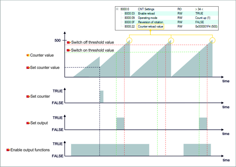

Counter mode
The CX7051 Embedded PC can be configured as an up/down counter that enables the counting of a pulse. The embedded PC is suitable for fast counting tasks with a cut-off frequency of up to 100 kHz, whereby the CX7051 can be operated in 1-counter mode.
The CX7051 supports three operation modes in counter mode:
- Up/down counter
- Up counter
- Down counter
In addition, output 1 can be switched depending on the counter value. Output 2 can be switched from the PLC. This allows fast control signals for field devices to be used and switched.
The operation modes are set in TwinCAT via CoE objects.
Up/down counter
In the up/down counter operation mode, the pulse to be counted is detected by digital input 1. The counting direction is specified by digital input 2.
If there is a high level at input 1 and at the same time at input 2, the counter counts upwards. If there is a high level at input 1 and a low level at input 2, the counter counts downwards.
Up counter
In this operation mode, the signal is detected at digital input 1.
Down counter
