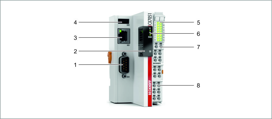

Structure
Structure 1:Fig.1: Sample configuration of a CX7051 Embedded PC.
Legend for the configuration of the basic CPU module
No.
Component
1
D-sub connector (X003).
CANopen interface of the CX705x.
2
MicroSD card slot (under the cover).
Slot for industrial MicroSD cards. Memory space for firmware and TwinCAT 3 projects.
3
Ethernet interface (X001)
For the connection to local networks. Serves as a programming interface.
4
USB interface (X002)
Interface for additional USB data storage device.
5
I/O Status LEDs
Diagnosis of the power supply for the Embedded PC and the terminal bus. Status of the E-bus or K-bus communication and multifunction I/Os.
6
Diagnostic LEDs
1 x TwinCAT Status, 1 x Flash access, 1 x Error LED.
7
Spring-loaded terminals, +24 V and 0 V
Power supply (Us) for Embedded PC.
8
Power supply (Up) for integrated multifunction I/Os and Bus Terminals via the power contacts.
