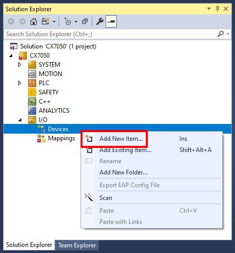

1. In the tree view on the left, right-click on Devices.
2. In the context menu click Add New Item.
Creating CX705x as slave 1:

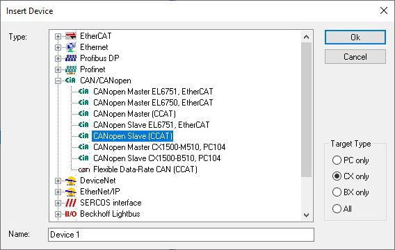

3. Select as device CANopen Slave (CCAT) and confirm the selection with OK.
Creating CX705x as slave 2:

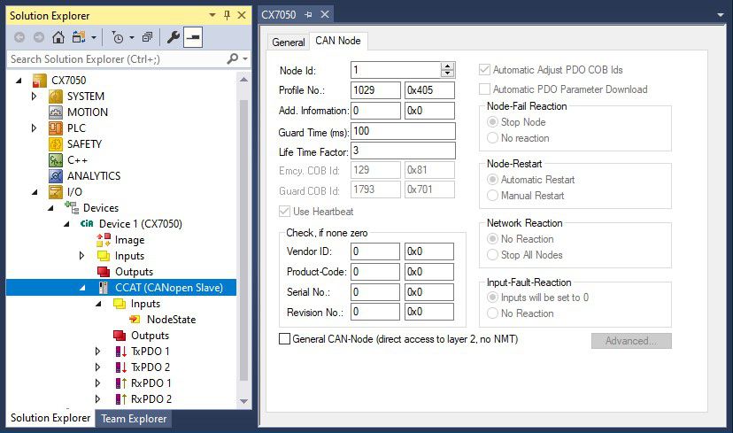

The CANopen slave has been successfully added in TwinCAT and is displayed in the tree view with the inputs and outputs.
Creating CX705x as slave 3:
In the next step you can extend the process image by creating additional virtual slaves. Or you can set the address, once the slave configuration is complete.
