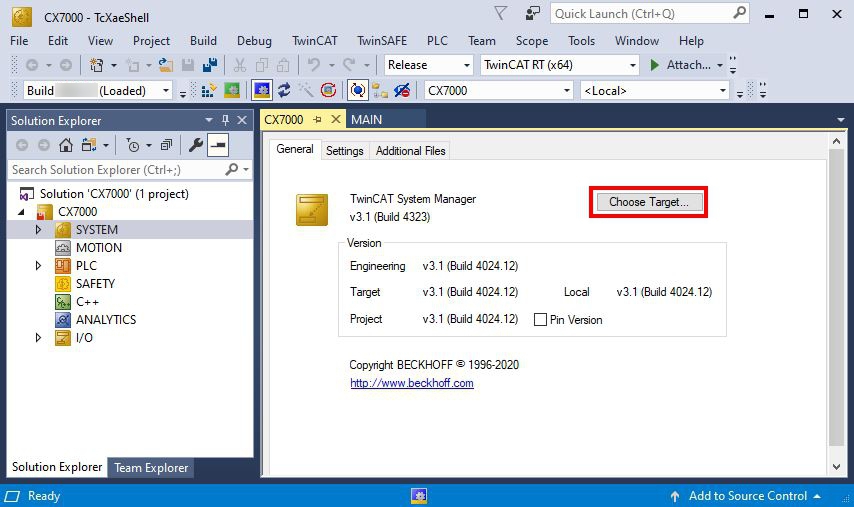

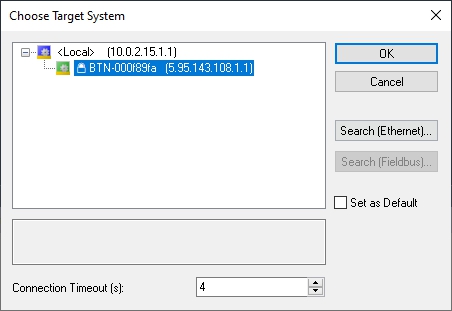

2. In the tree view on the left click on SYSTEM, and then Choose Target.

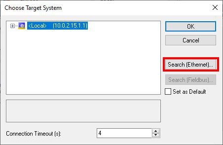

Connect to the CX70x0 1:
3. Click on Search (Ethernet).

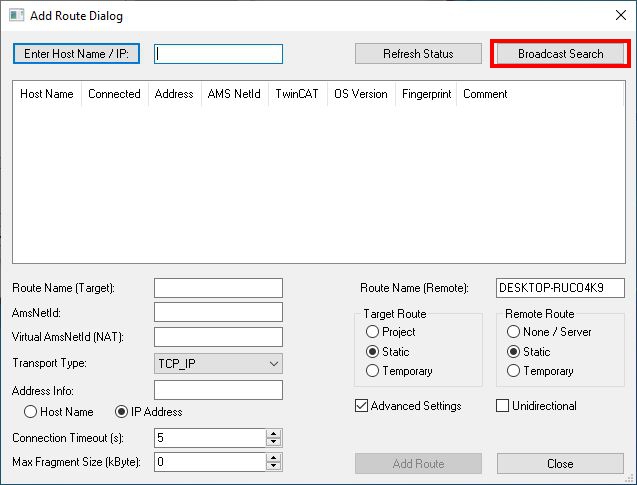

Connect to the CX70x0 2:
4. Click Broadcast Search and search for available devices on the network.

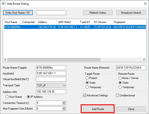

Connect to the CX70x0 3:
5. Mark the appropriate CX7051 and click Add Route. The host name and IP address facilitate identification.

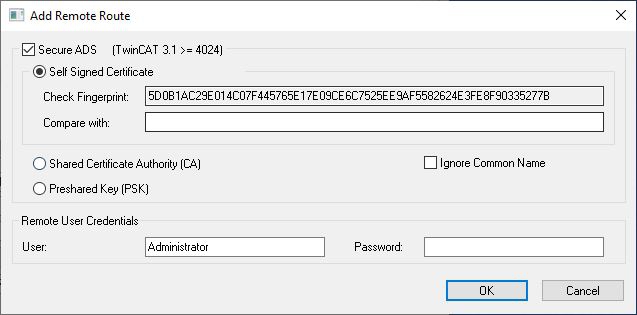

Connect to the CX70x0 4:
6. Enter the user name and password in the User and Password fields respectively and click OK. User name: Administrator Password: 1
Connect to the CX70x0 5:
7. The new device is displayed in the Choose Target System window.
8. Select the device you want to specify as target system and click OK.

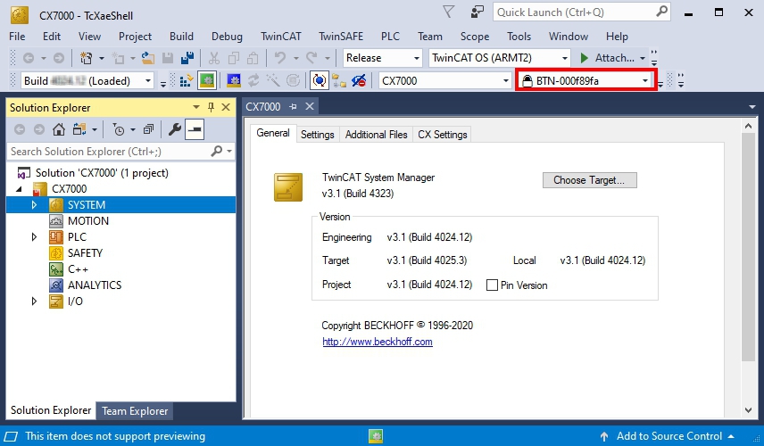

Connect to the CX70x0 6:
You have successfully established a connection between your engineering computer and the CX7051 (target system) in TwinCAT. The new target system and the host name are displayed in the menu bar.
Connect to the CX70x0 7:
Using this procedure you can search for all available devices and also switch between the target systems at any time.
