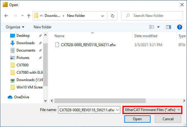

- 4. Click the Download button and select a current efw file.
- The update takes about 3 to 4 minutes. A progress bar indicates the progress of the update. Do not switch the CX7050 off during this time.
