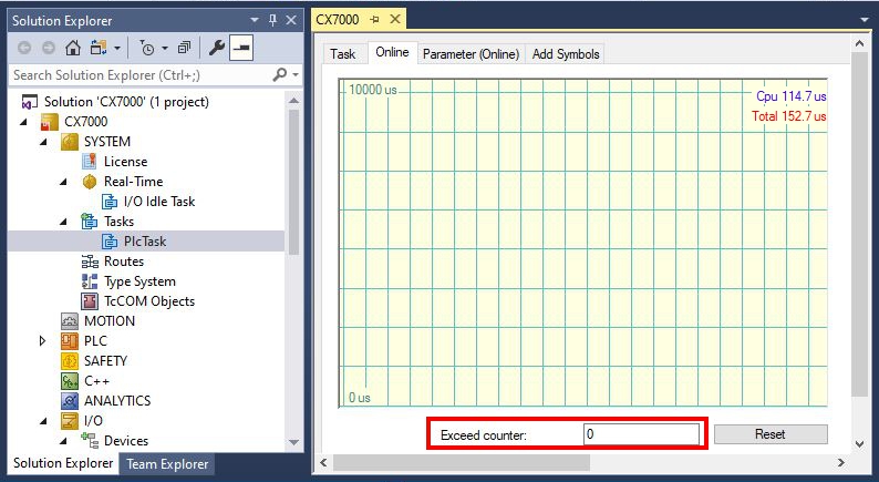

Observe the exceed counter
The exceed counter is incremented as soon as the PLC no longer works in synchronization with the cycle and the defined task time is exceeded. Ideally, the counter value should be zero.
Fig.76: Display of the exceed counter in TwinCAT.It is possible for the exceed counter to be incremented at the start of the PLC, for example, because the PLC is called for the first time or certain components are initialized. Observe the exceed counter over a period of several hours. One can only speak of a stable state when the exceed counter is no longer incremented over a longer period of time.

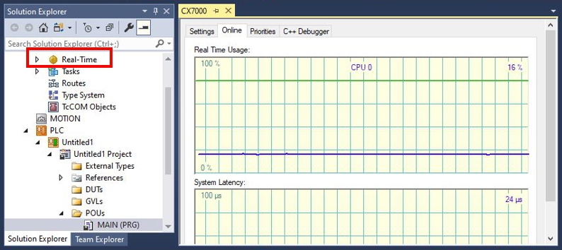

Check the CPU load
In TwinCAT, the CPU load is displayed under Realtime and on the Online tab. Check the value to determine whether you can run additional program code or reduce the task time.
Fig.77: Display of the CPU load in TwinCAT.The light green line indicates the preset CPU limit. If the load is ≥ 65%, the CX7050 is already very busy and no more code should be executed or the task time shortened. You should not go to the limit and use the CX7050 to full capacity.

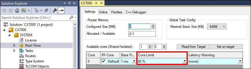

By default, the real-time is set to 80%. This is already the maximum value and an increase to 90% is equivalent to an increase to 100%.
Fig.78: Setting the real-time load in TwinCAT.TwinCAT would then consume all the CPU power, and services that the operating system serves would no longer work or would not work adequately. If you increase the real-time load to 90%, you should be aware of the potential consequences for the operating system.
