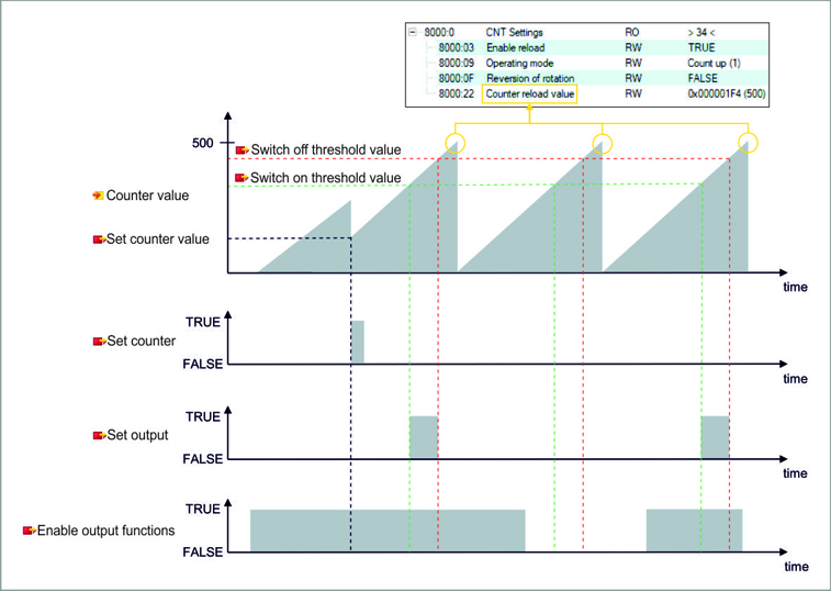

Counter mode 1:Fig.21: Configurable inputs and outputs in counter mode.
The CX7031 supports three operation modes in counter mode:
In addition, output 1 can be switched depending on the counter value. Output 2 can be switched from the PLC. This allows fast control signals for field devices to be used and switched.
The operation modes are set in TwinCAT via CoE objects.

Counter mode 2:
Technical data, multi-function I/Os in counter mode.
