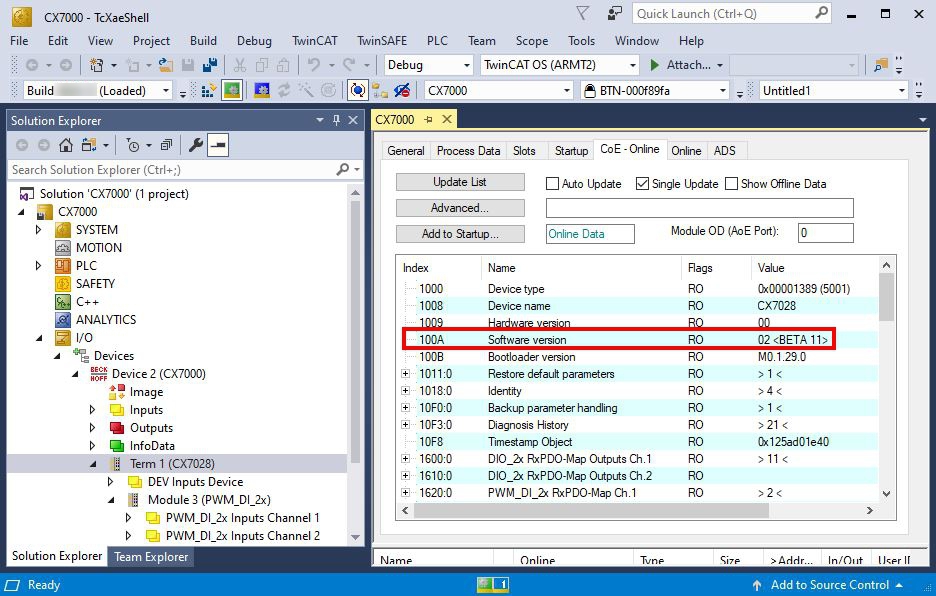

nErrId=> );The index number for the CoE object Software version is located under the CoE Online tab.
Fig.32: CoE communication, listing of CoE objects with matching index number.With the FB_EcCoeSdoWriteEx function block an object from the object directory of an EtherCAT slave can be written by SDO-Download. Pay attention to whether the object can be accessed for reading; this is displayed in the Flags column. The nSubIndex and nIndex parameters allow the object that is to be written to be selected. Via bCompleteAccess := TRUE the parameter can be written with subelements.
