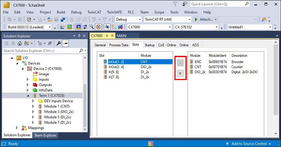

A total of four adjustable slots are available for configuring the operation modes. A slot is a certain number of inputs and outputs. For each slot a maximum of one module (DI, DIO, ENC, CNT or PWM) can be assigned, which in turn determines the operation mode for the respective slot. A module is therefore a function that these inputs and outputs can assume. The current module configuration is listed in TwinCAT under the CX7028 interface. Note that the CX7028 interface for controlling the multifunction I/Os has its own CPU and the CX7028 interface is not displayed or does not work under TwinCAT if the power supply (Up) is not connected.
Multifunction I/Os 1:Fig.14: CX7028 interface, slot and module configuration under TwinCAT.
Modules can be assigned to a specific slot with the button < or removed again with x. There is a choice of different modules depending on the slot used. The module used by each slot is listed in the following.
