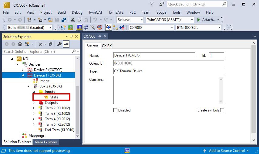

K-bus interface
The CX7031 reads out the terminal types during scanning and creates them in the System Manager under a bus coupler.
Fig.33: K-bus interface of a CX7031 in the TwinCAT System Manager.For K-bus diagnostics there is a status variable in TwinCAT under the bus coupler, which can be used for diagnostic purposes and indicates the status of the K-bus communication. For more information, refer to the chapter "Error handling and diagnostics" at K-bus.

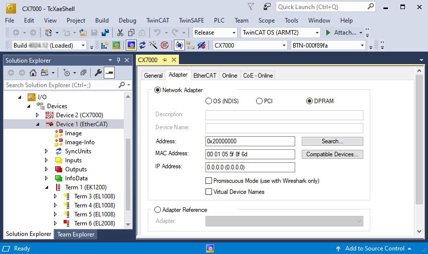

The operation of EtherCAT Terminals and EtherCAT devices is also possible on the CX7031. The CX7031 also recognizes these terminals automatically during scanning, reads out the terminal types and creates them in the System Manager under an EtherCAT Coupler.
Fig.34: E-bus interface of a CX7031 in the TwinCAT System Manager.For more information on diagnostics, refer to the chapter "Error handling and diagnostics" at E-bus.
