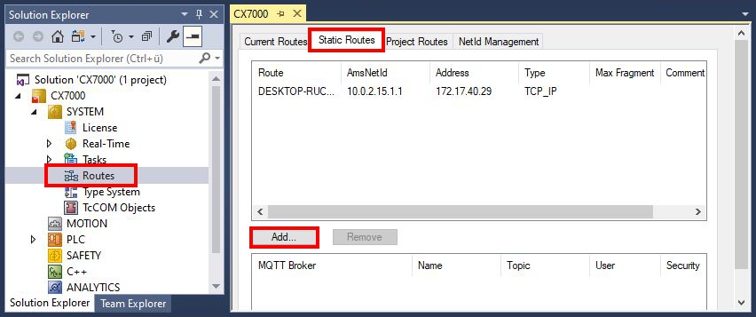

2. On the left in the tree view, click Routes, select the Static Routes tab, and click the Add button.
Establishing ADS communication 1:

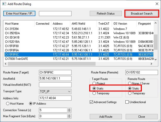

3. Under Remote Route, select the Static option so that the ADS route remains in the project, and then click the Broadcast Search button.
Establishing ADS communication 2:

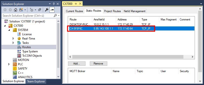

4. Select the second CX70x0 as the destination of the ADS route. The ADS route is entered for both Embedded PCs. The AmsNetId of the second CX70x0 is displayed and can be used in the program for ADS function blocks.
Establishing ADS communication 3:
