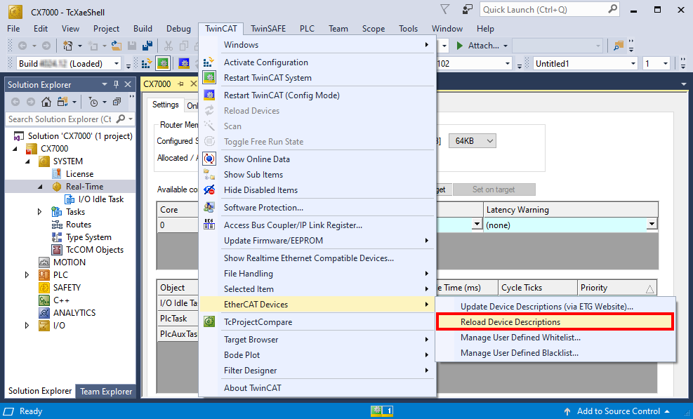

- 1. Copy the ESI file into the TwinCAT installation directory: \TwinCAT\3.1\Config\Io\OnboardIo.
- 2. Create the folder manually if it doesn't exist.
- 3. Open TwinCAT and click in the menu under TwinCAT > EtherCAT Devices on Reload Device Description.
- The ESI file is re-read into TwinCAT. An error is returned if there is a faulty ESI file. Check whether the structure of the *.xml corresponds to the associated *.xsd file or whether the files match the CX7000.
