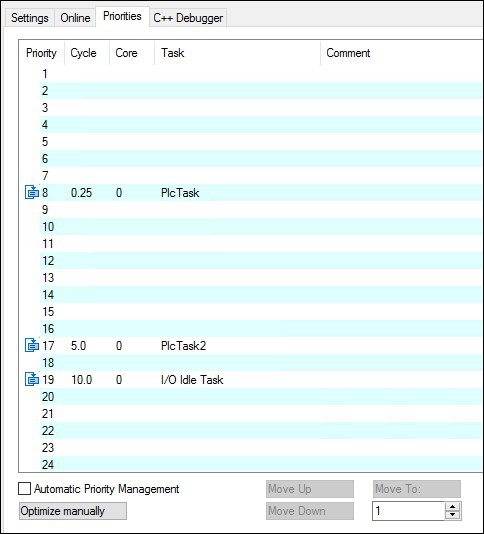

In addition, you should set the priority of the task so that the 250 μs task has the highest priority in the system.

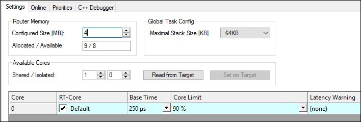

  1. Connect the +24 V Up and 0 V Up power supply to power the multifunction I/Os.
  2. Connect output 1 to input 1 to toggle the output as described.
  3. Connect output 2 to input 2.
  4. Set the core limit to 90%, the base time to 250 μs, the priority of the fast task to the highest priority, and the idle task to 10 ms.

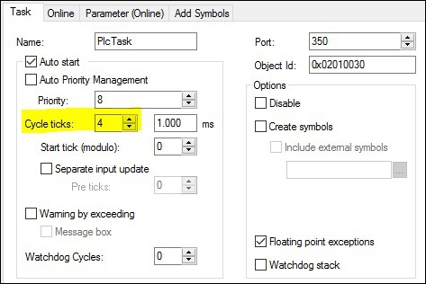

The inputs have only a minimal filter time and are therefore well suited for the measurement. A load on the output is not necessary in this case. For the following samples, we always leave the base time at 250 μs and only increase the number of cycle ticks in order to set the corresponding task time.

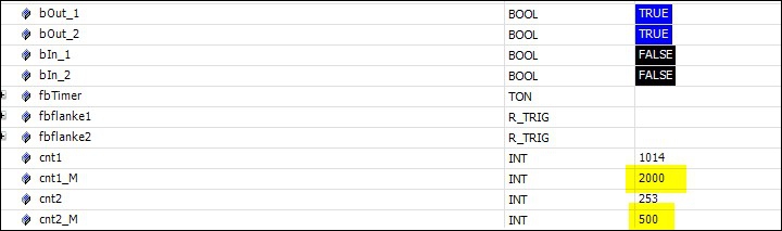

The toggling of the output results in a frequency of 2 kHz – 250 μs On, 250 μs Off – i.e. a period duration of 500 μs. When measuring the positive edge, this is 2000 edge changes in one second.
Cycle time of 250 μs 4:Fig.33: Measurement at a task time of 250 μs.
In the case of the response time, it is 500 changes in one second, as the optimized access to the inputs does not apply here.

Cycle time of 250 μs 6:Fig.35: Measurement at a task time of 1 ms.
With a task time of 1 ms, you can clearly see that the optimized mode actually helps to reduce the response time. While the toggle change has halved again, i.e. it is now still 500 Hz with a task time of 1 ms, the value for the response time has remained the same.
