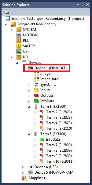

1. In the tree view click on the EtherCAT master.

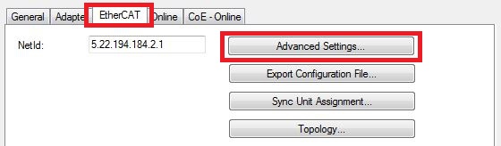

2. Click on the EtherCAT tab, then Advanced Settings.

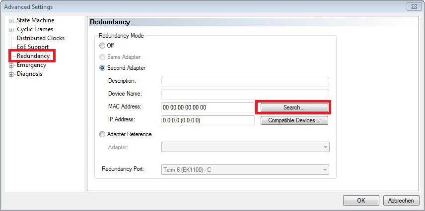

3. Click on Redundancy in the structure tree on the left.
4. Click the Second Adapter option and then the Search button.

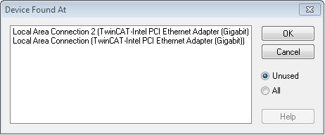

5. Select the appropriate LAN connection according to your cabling at the embedded PC.
Configuring EtherCAT cable redundancy. 5:
6. Confirm your settings with Ok.

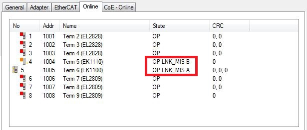

You have successfully configured cable redundancy. The EtherCAT slaves configured for cable redundancy are displayed in the Online tab.
The state of the individual EtherCAT slaves can be found in the State column. If, for example, the cable connection between the EK1100 and EK1110 Bus Couplers is interrupted, the status of the Bus Coupler changes. The message "LINK_MIS B" and "LINK_MIS A" then appears in the State column.
Configuring EtherCAT cable redundancy. 6:
Although the connection between the Bus Couplers is interrupted, the EtherCAT Terminals connected to the EK1100 Bus Coupler do not have a fault.

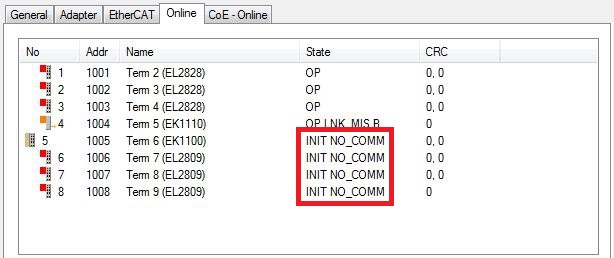

If the cable connection is interrupted at the same point without cable redundancy, a fault is displayed for the terminals in the State column.
