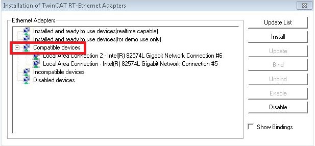

- 1. Double-click the TcRteInstall.exe file.
The installation dialog appears and shows the compatible Ethernet interfaces under Compatible devices.
- 2. Select the Ethernet interfaces for which you wish to restore the Beckhoff real-time driver and click on Install.
- The Beckhoff real-time driver is installed. The Ethernet interfaces with installed Beckhoff real-time driver are shown under Installed and ready to use devices (real-time capable).
