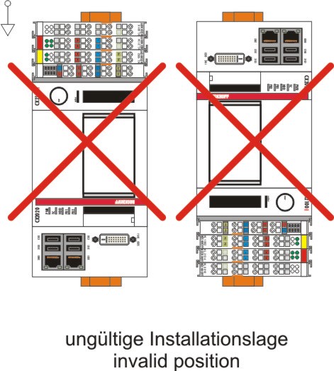

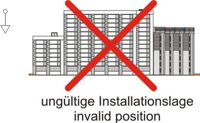

The images below show the permitted and two unacceptable installation positions:

Incorrect installation positions
The CX20x0 system must not be operated vertically on the DIN rail. This installation position provides insufficient ventilation for the devices. In horizontal position the devices are not sufficiently ventilated either.
